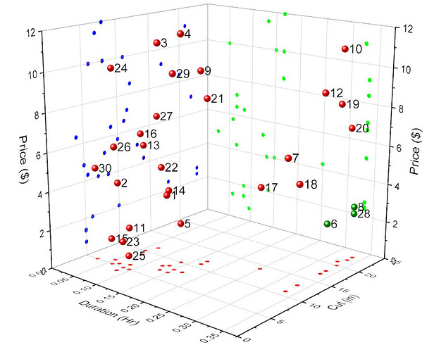

Did a 3d plot of your data. Lower right corner is best (longest lasting, most cut, least $). They are Bauer, Blackhawk, Benchmark.
Interesting clustering. To another participants point, those disks that lasted 20 minutes, should be run to destruction to see if there are front runners.
