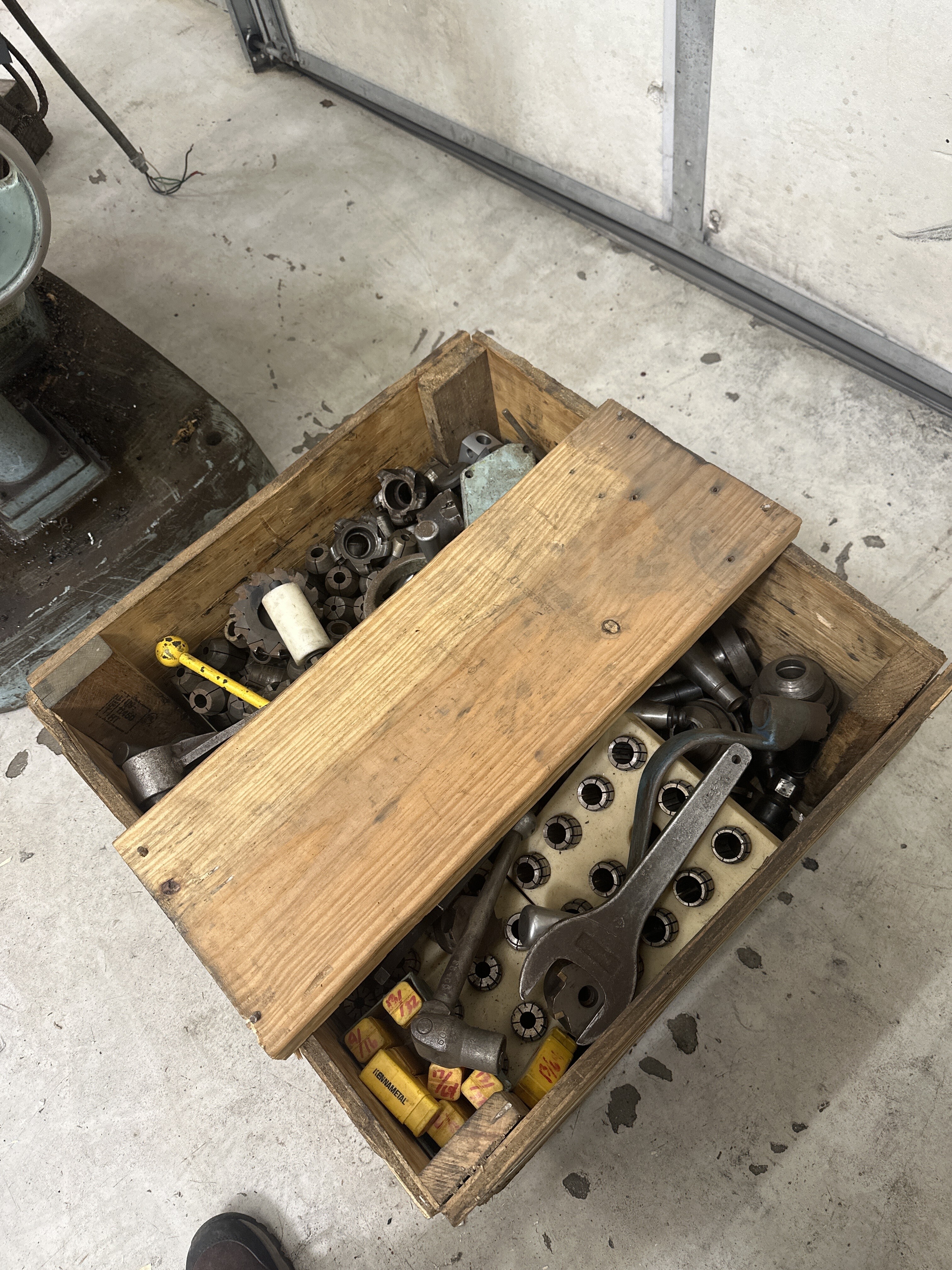

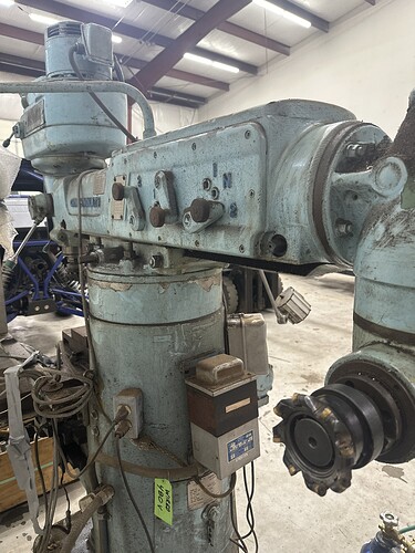

This is why I like old stuff. 3200 bucks. And tooling. I like to make them perfect again. It’s a weirdo. Parts are tuff though
I’d love to be able to do a “refurb” but I don’t know shit about them. All I know is that the straighter/flatter the better. I’ve been told to spend time on setup when I get something and check it periodically as I use it. Again……I’m worse than a “nob” because I’ve read so much crap. lol.
