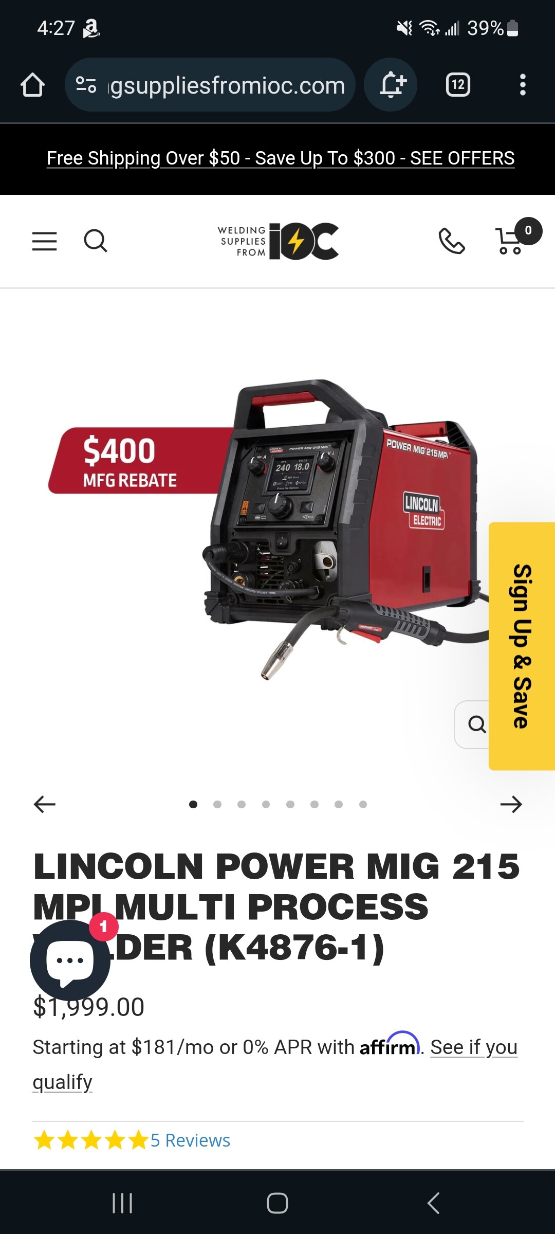

I recently bought a ESAB Rebel 205ic, it will run mig and flux core wire, AC/DC stick and AC/DC tig with variable frequency on AC tig. The whole machine weighs about 35 pounds and costs about $4000.
For what you will be doing, a multiprocess lincoln, esab, miller, AND Harbor freight vulcan or titanium will suit your needs for under $2,000.
I have a Lincoln 210 at home and use Miller at work. It’s Ford verses Chevy. ESAB (and a couple other brands) have great reputations. Harbor freight has upped their game significantly with their top two lines of welders.
Something to think about: My Lincoln simplifies a lot of brainwork for settings. You plug in metal thickness, wire thickness, and it goes to spot-on settings. It shows everything on a display. The other brands have similiar style machines. You can still easily tweak the settings.
Something to keep in mind: Whether you need a dual voltage welder.  Having the 110 volt option is handy.
If someone doesn't weld for their career, The MP welders with simple displays are a great way for them to remove doubt on settings.  That's my advice.
All three have rebates going on. Sometimes welding ioc will have a helmet deal if you buy a welder, too. Again, there are other brands with good reputations. Prime weld is another brand, I believe. I just don’t have info on that.
