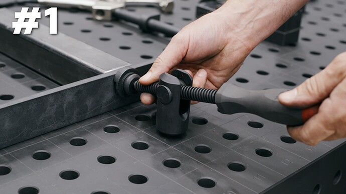

1. Gooseneck Clamp Hack
Split the 90° Gooseneck into two pieces, use just the side-pusher half. Simple and effective.

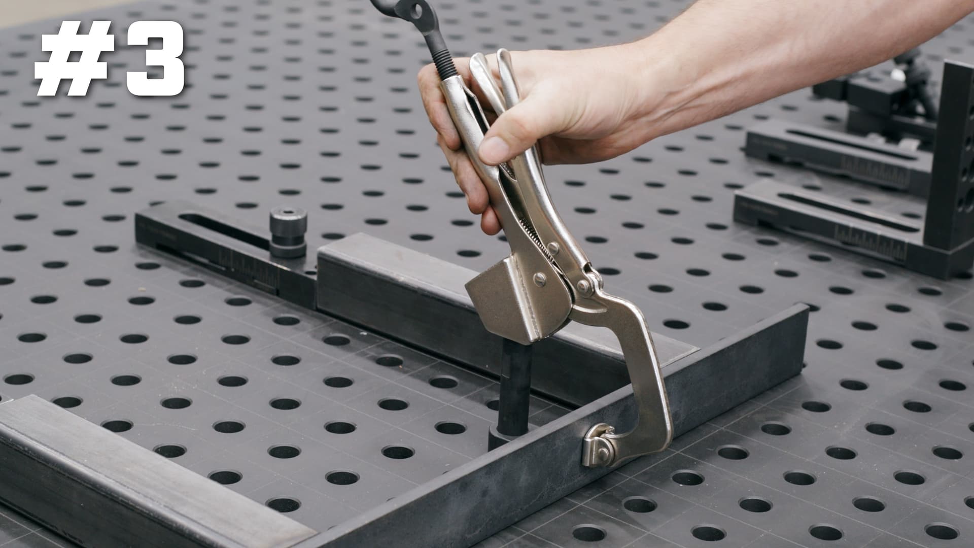

3. Twin Pin Plier
Uses two rod positions for vertical or side clamping. Drop it in a table hole and pull your part tight.

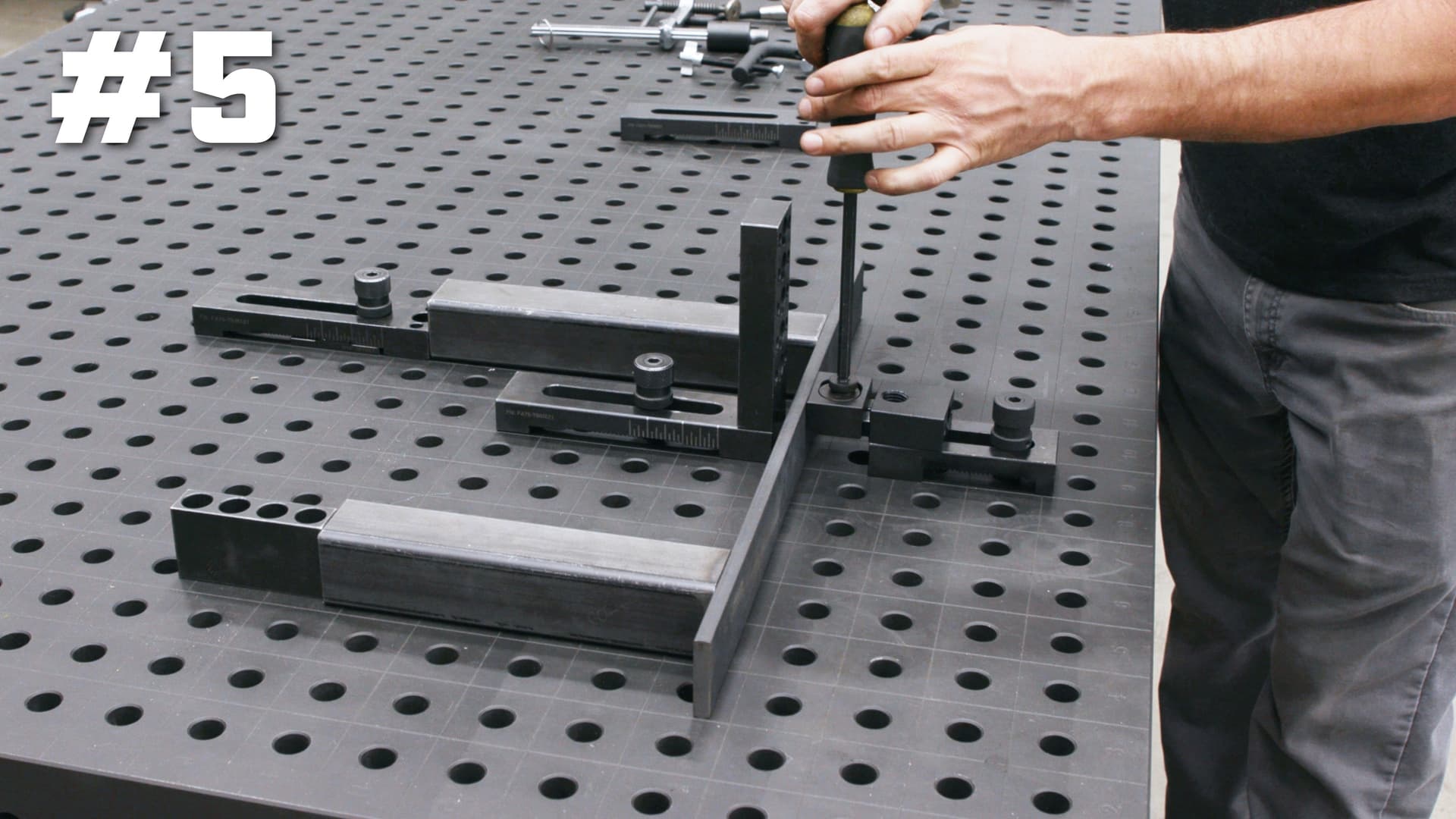

5. Low Profile Push Clamp + Tooth Block
Lock it in with a pin, then use the cam to push. Great for fast part changes like pulling parts in and out.

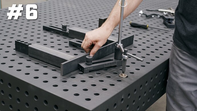

6. Tooth Block Wedge
Drop it at the end of a hole and use the cam to bind. You can also add a second clamp to resist rotation if needed.

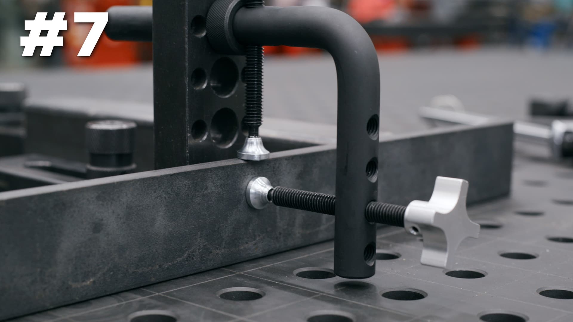

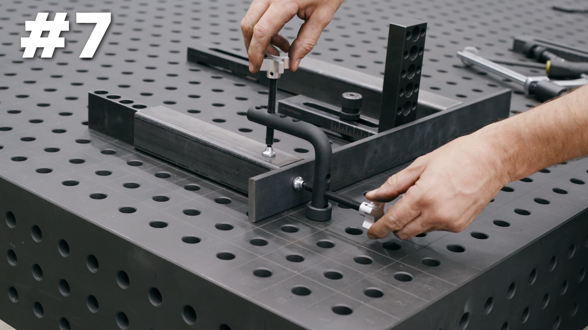

7. New Clamp Prototype
We’re still working on the name, (Twin Screw or maybe Double Dragon) but this prototype lets you clamp from the side and the top simultaneously.
But wait, there’s more!
It can also be used on a riser for even more clamping capabilities.
It’s not released yet, but we wanted to give you a sneak peek. And if you’ve got a good name for this guy, please post it down below!
