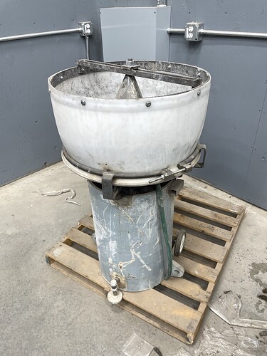

I’d thought I’d share some of the metal tumblers that I’ve seen a used.
This tire tumbler is cool. I’m sure a 33-35 tire could be turned into a tumbler. It was also pretty quiet running for a tumbler.

I made this one when I first started fireball to clean diy square kits. It uses an old plastic barrel. The motor mounts vertical spinning an offset weight. A rubber hose is used as a damping coupler. The spinning shakes the barrel on the springs. Basically a giant version of the small bench top tumbler. It worked ok but all the parts went straight to the bottom and didn’t turn over often enough.
