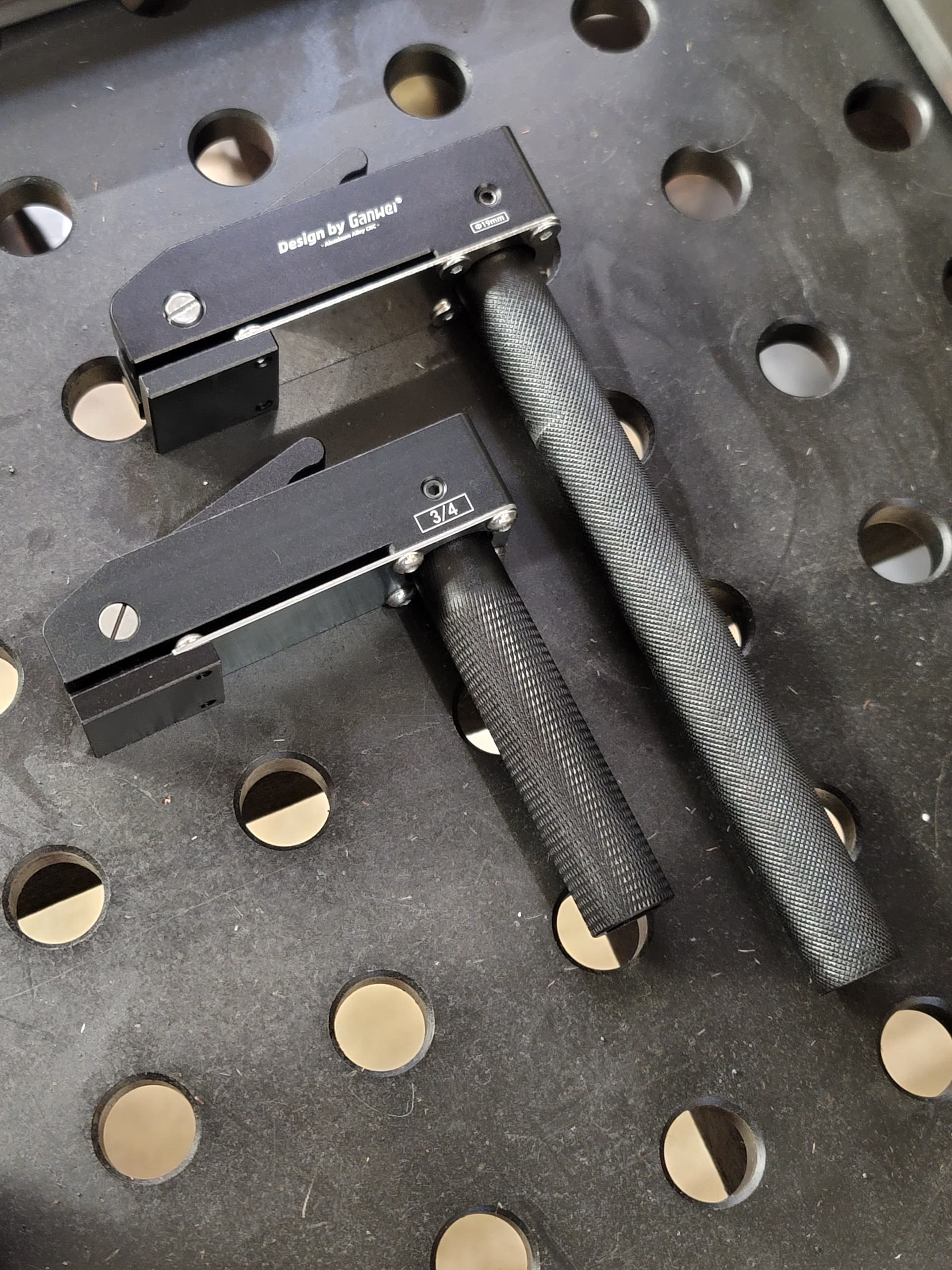

Cam clamps ($10-12 depending on length):
I picked these up figuring they’d be worth a look, and probably totally adequate to hold down a table topper or parts that aren’t thick and likely to warp like crazy. I’m not disappointed with them, but I can definitely imagine they will be much quicker to wear out than any of the clamps from Fireball due to the cam action being anodized aluminum on anodized aluminum. They do seem to develop more clamping power than I anticipated they would, so in a pinch I wouldn’t have a problem using them in an important setup if nothing else will fit in the available space, but I’ll mostly use them in situations where they will see less load just to help them last longer.
