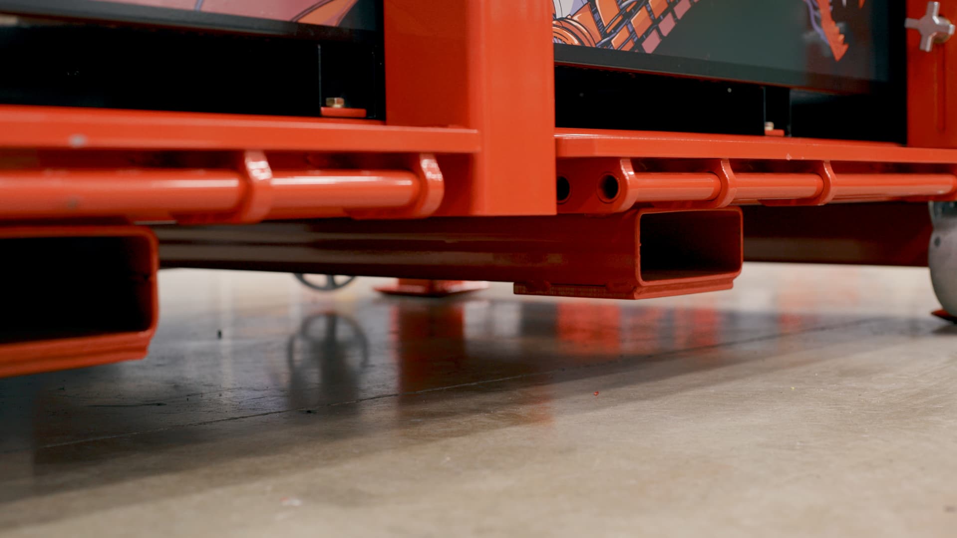

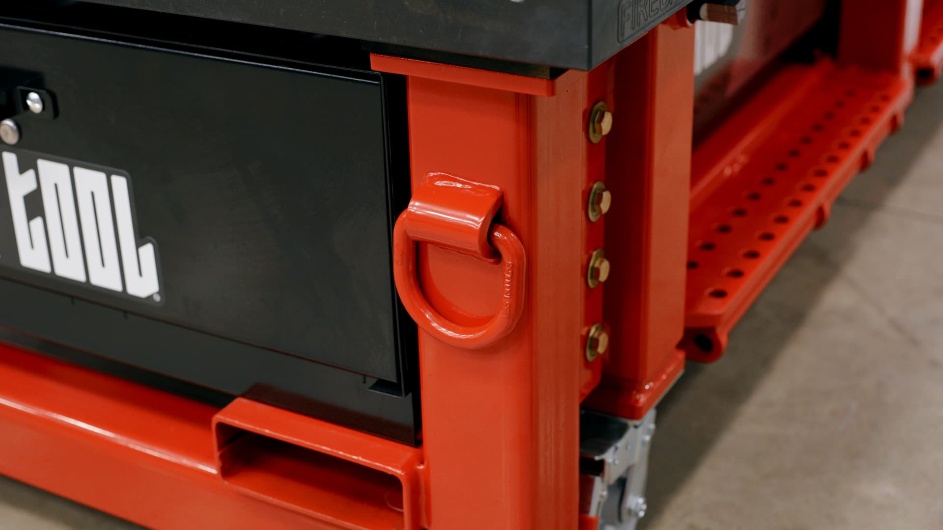

We made it as easy as possible to get off the truck and onto your floor. There are fork pockets on all four sides, so whether you’ve got a narrow shop or a big open bay, you’ll have a way to lift it. Use the D-rings to pull it, don’t yank on the table itself.

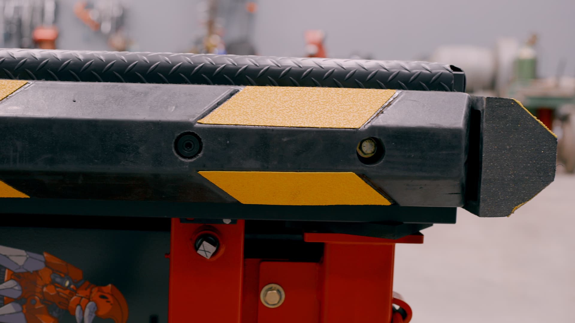

Once it’s on the ground, pull off the bumpers (they’re held on with the same fasteners we use on the tables), roll up the rubber cover, and store them somewhere safe.You’ll need them when it’s time to ship it again.

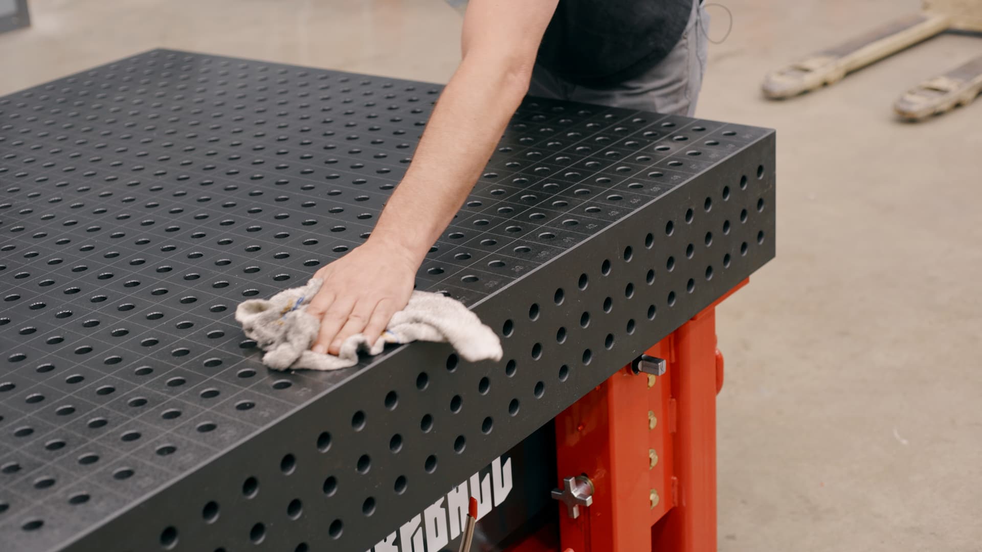

Before you ship the table, give it a wipe-down. A light mist of WD-40, a quick pass with a rag, and a brush through the holes goes a long way. We’re counting on everyone to treat this like a community tool. Please leave it better than you found it.
Now the cover gets rolled back on, the bumpers get bolted back in, and you’re good to go. No crate required. We’ve designed those bumpers to take forklift abuse without building some giant shipping box.
