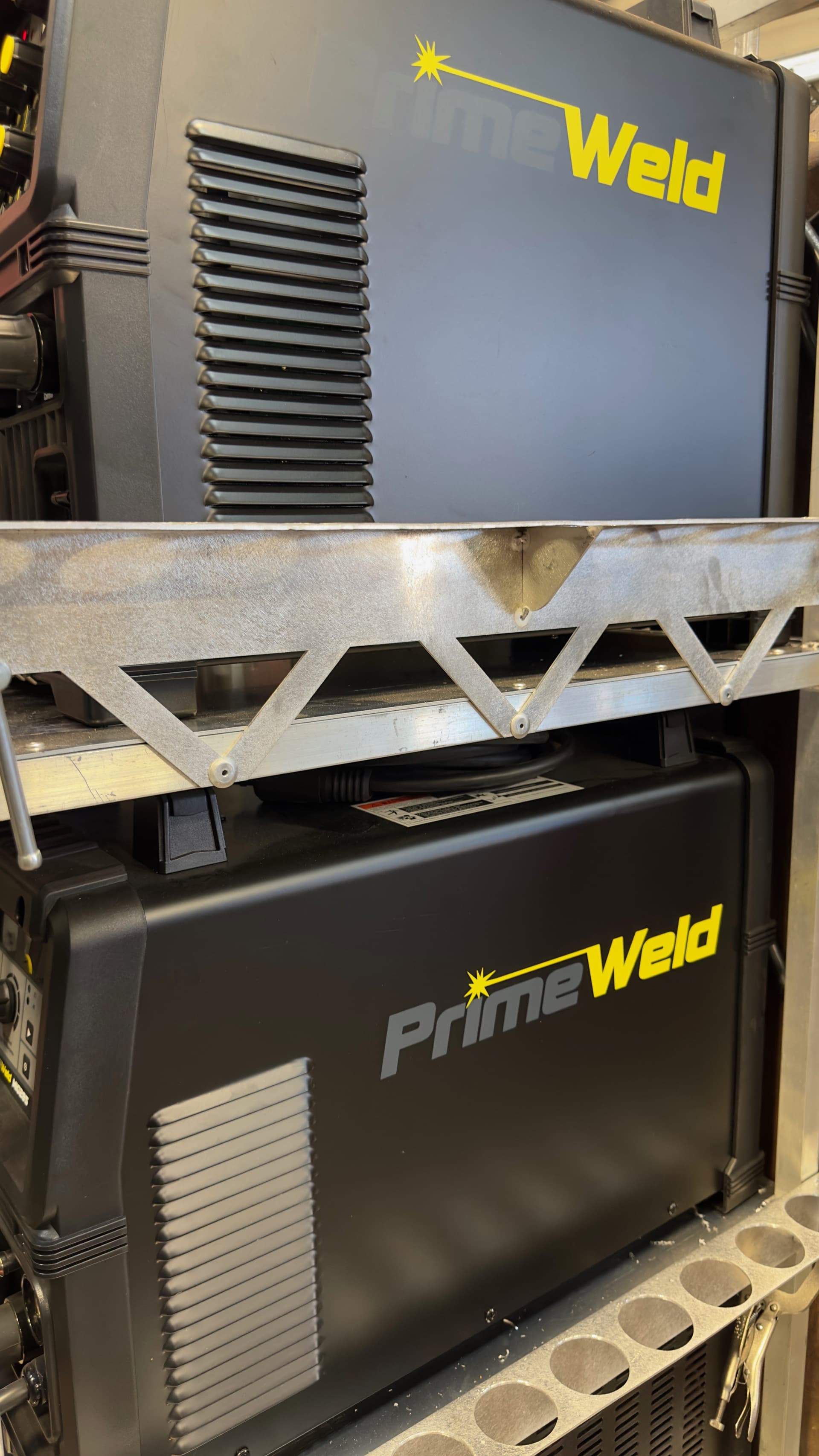

I just realized today that I never posted my weld cart after I finished it. It is all aluminum with laser cut bottle brackets.
That’s text book fixturing right there! Great use of the dog leg fences on the tooth blocks.
If only someone made a super handy table with a ton of useful intuitive fixtures, I wouldn’t have to rig up stuff like this!:joy::joy::joy::joy:……
Man the Trenton to detail! So ho much time do you recon the dragon wagon nocked off the build?
Honestly probably a full days worth of work. I only get about 4-6 hours a night in my shop after work and often have plenty of other things going on for either myself or customers. Actually i think we were rebuilding an ISX in an 389 peterbilt, so this took me a couple days to build going back and forth. Putting it into cad saves a ton. I mean everything fits very tight and that’s exactly how i wanted it. I also hung some race trailer accessories from Pit Posse and that’s where i store my small map gas, extra consumables, and paper towels. I’ll drop a few more pics today. I believe i posted it on my fab page on Facebook @ Lava-Torch Fabrication if you want to check it out there.
