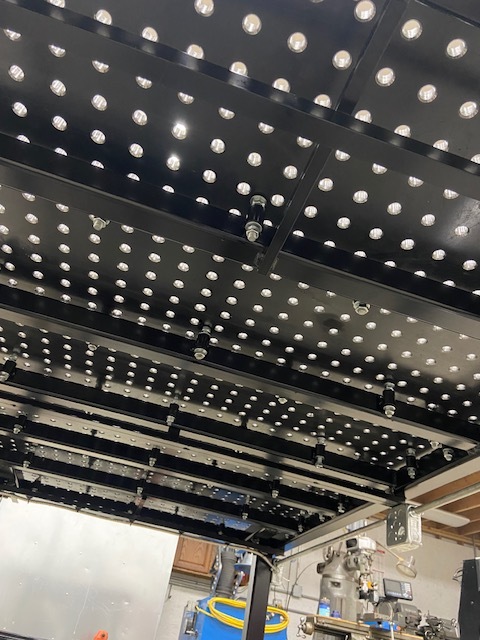

Here is the table I have been working on in between Jobs.
5 x 8 x 3/4"
5/8" holes 2" grid
Casters are just so I can move it for cleaning.
The top mounts to the frame with studs which I hope will allow me get it close to being flat.
I can either push up or pull down with ea stud (we will se if it works like I think)
Very nice! Refresh my memory… how did you get the holes cut? Jig and drill, laser, etc…
Machine shop cut on a large mill, in fact that plate looked pretty small on the lathe.

Those will come off once put where it belongs. Those are just so I can move it for cleaning.
Let me know how your bolt down system works, I’ve been cyphering on this for mine for a while. I’m nowhere near finished drilling all my holes but might start on the frame here shortly. looks slick
It will be a few weeks, But I will definitely will let you know. I am keeping my fingers crossed :grinning_face_with_smiling_eyes:
Just from a quick look, why could’nt the casters be mounted on the inside of each leg so they would be under the table and harder for you to kick? Also, since they are just as functional for moving the table when necessary, they could be left on the table permanently…just thinking!
I am not sure I had the room to do that. I have a shelf that might be in the way.
