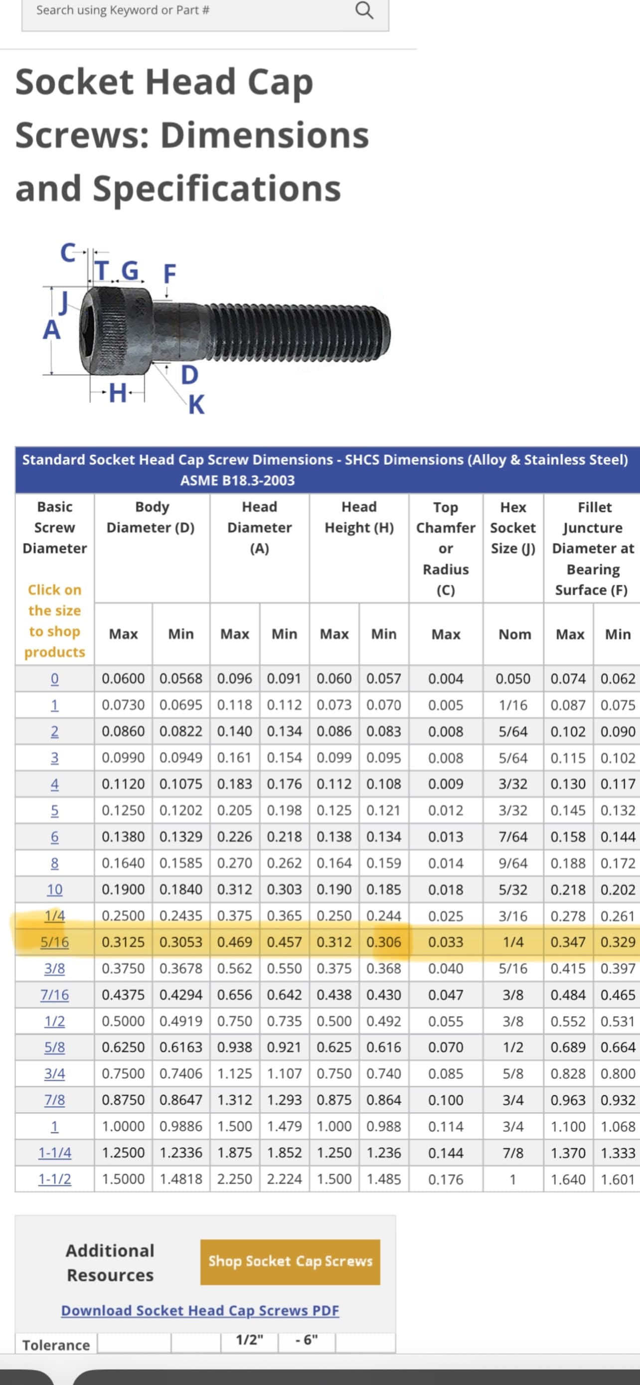

    I am planning to use 1/2 thick flat bar cut to a final width of 8in for the apron.
  2. Do you think 0.188in is enough thickness to support bolting the 1/2in flat bar to the main plate?
    After recessing the 5/16” socket head cap bolt into 1/2in flat bar I will only be left 0.188in of metal. I got the bolt head height of 0.312in from online.
