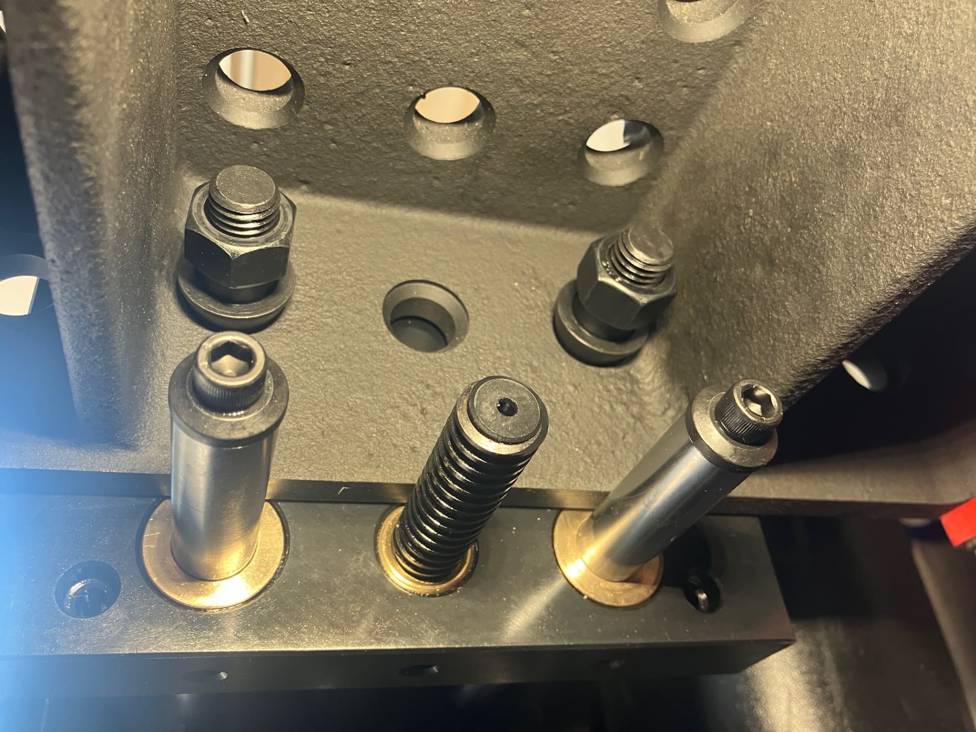

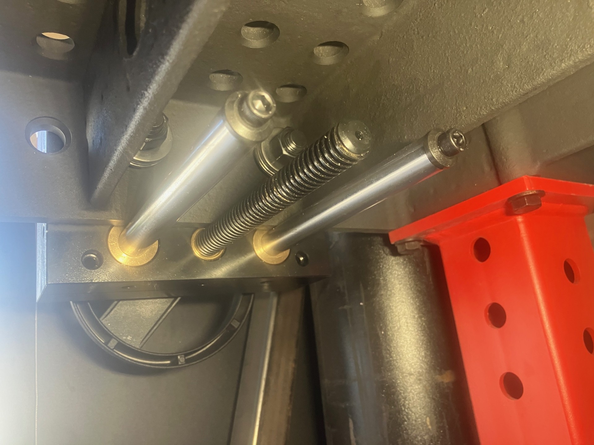

Im wondering if I am installing the vise incorrectly or if I have the wrong shoulder bolts. Any thoughts? The nut bottoms out on the shoulder of the bolt. And unfortunately I don’t have any washer large enough to make up the difference.
Looks like you might have gotten the shoulder bolts for the HD Tables, reach out to customer service and they can get you sorted out. @VC3 @CustomerService

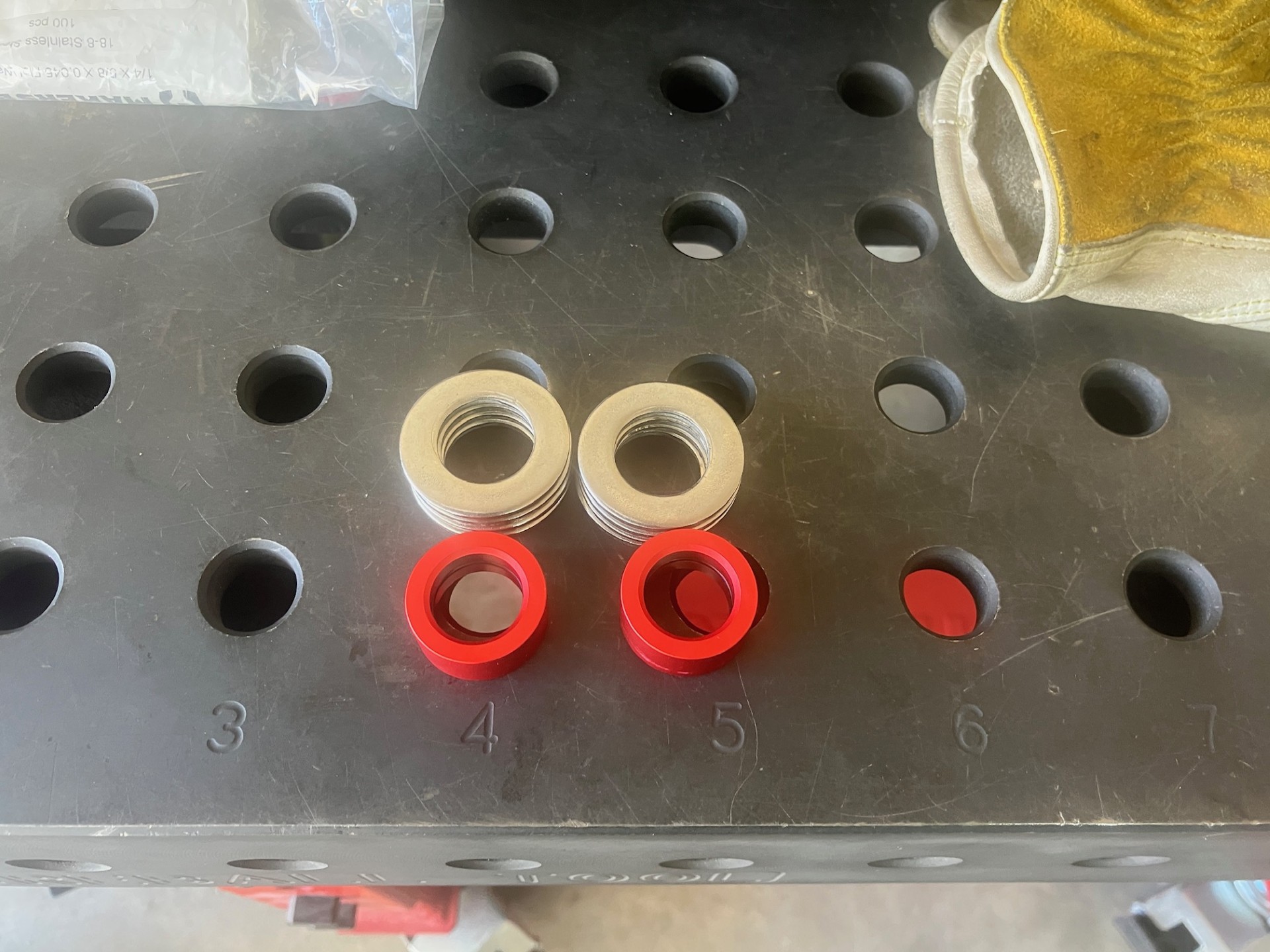

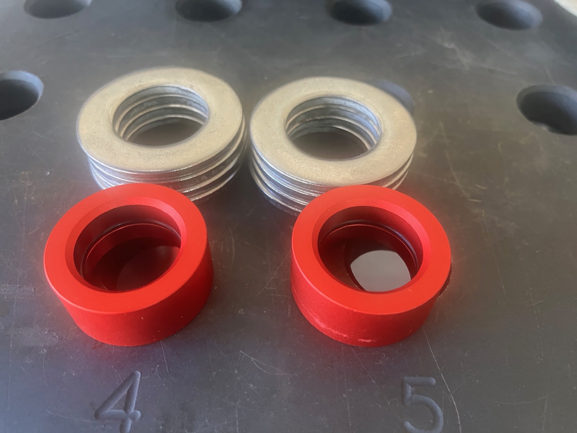

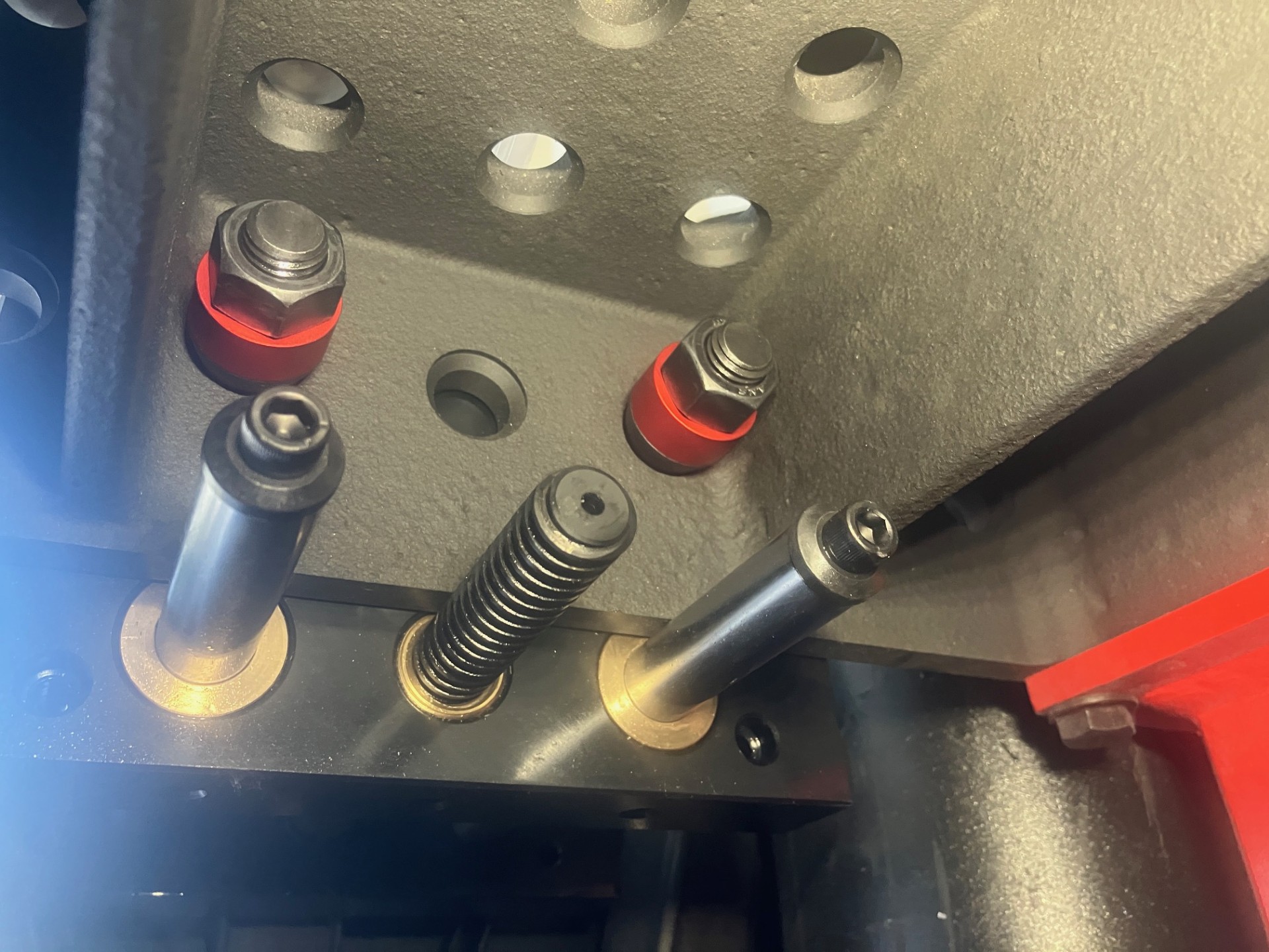

I had a temporary fix of staking a few washers. Just got in the spacers from Fireball Tool this weekend. Much better solution. Thanks.
