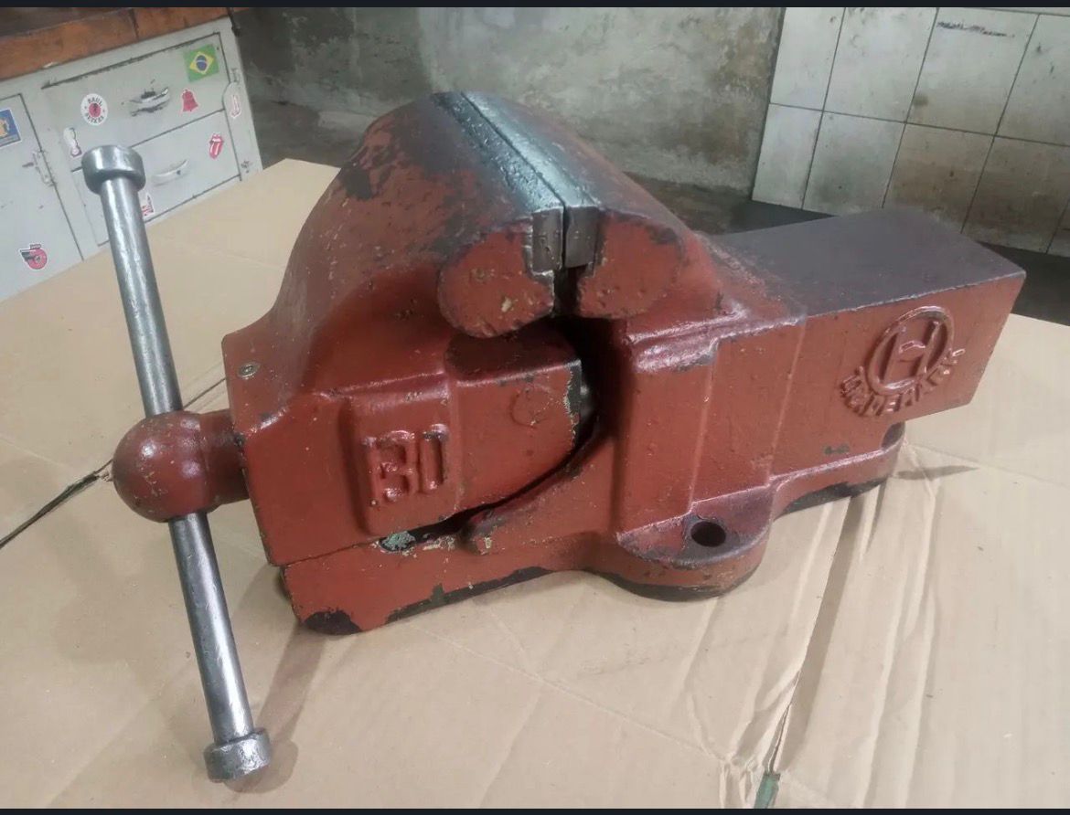

This vise just popped up for sale in my country (Brazil). It’s identical to the compact hardtail vise, and you can see it’s an old vise. It surprised me quite a bit.
Well, it’s not identical. It has a much better mounting foot that gets the fixed jaw over the edge of the table.
