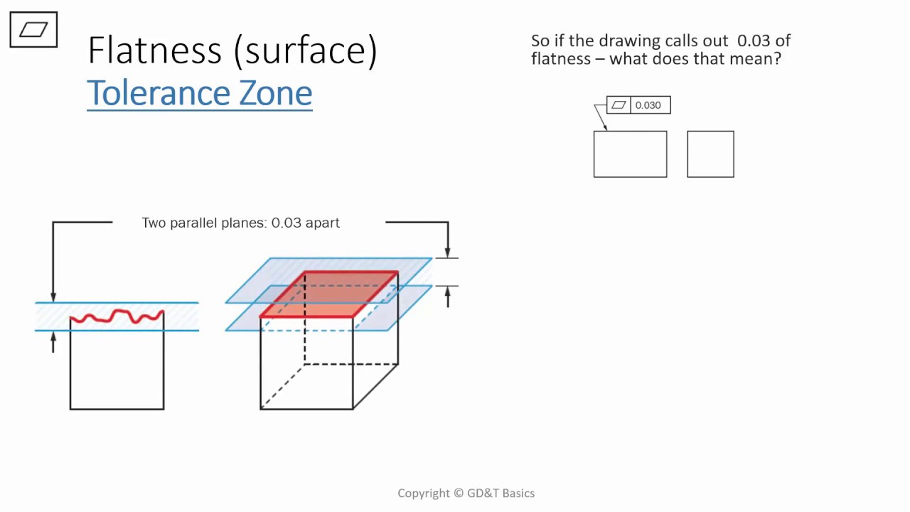

Looks like you didn’t fully understand the print. You’d be right if he didn’t have a flatness callout of 1/16.
This part has a flatness caliout of 0.03 but the height could be ±2" for all we know:
That means it could be a 45˚ mitred cut and still be in spec as long as it makes a plane within that 0.03 spec since parallelism wasn’t called out whereas your bowed idea would meet the dimensional callout but fails the flatness since it would only be flat within .125" and that is more than allowed. I don’t see an angular tolerance in the title block so I’d say this drawing is incomplete and I’d ask for clarification. Sure it could just be limited by the dimensional tolerances and I’d check that anyway but I still like complete drawings. I’m odd like that.
