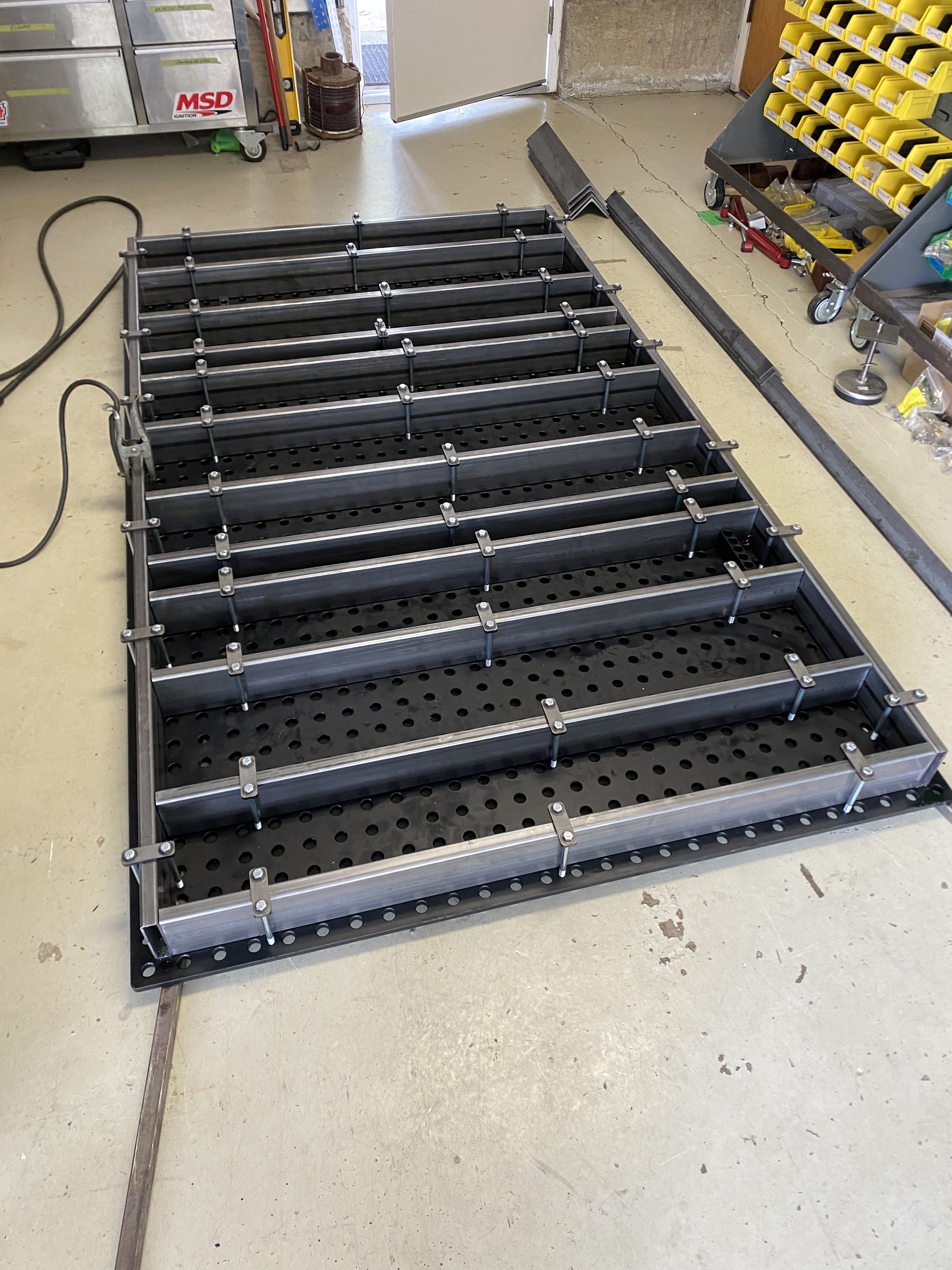

Here’s what I’ve got so far… I’ll need to add some more beams for the bottom shelf, but you get the idea
Looks great. It will be cool to see it finished. You might need a 3rd leg on the long side if it feels a bit bouncy.

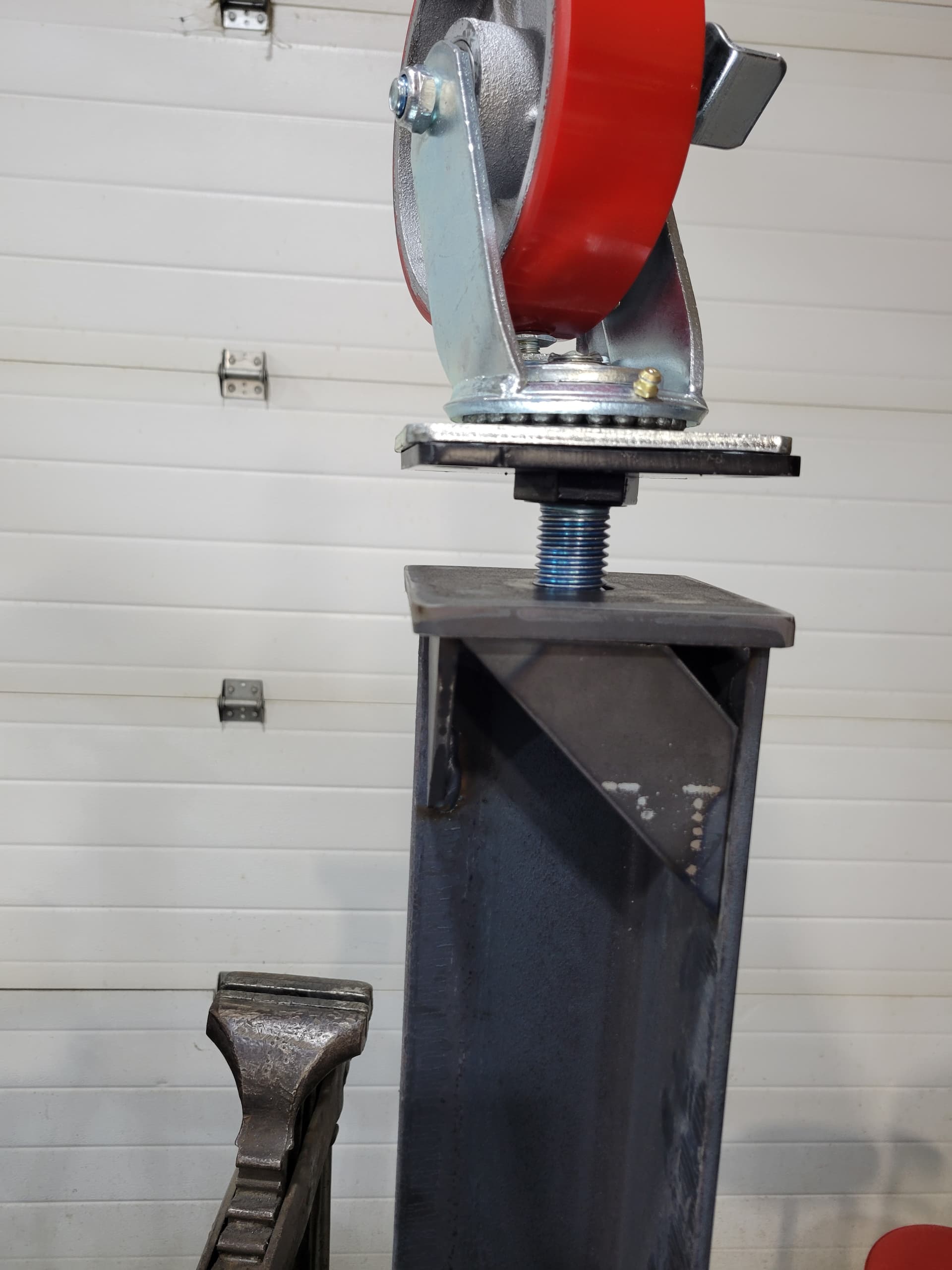

I have also been working on building a table using three of these plates. I stuck with the 2x1 .120 wall tube and built the outsides in more of a truss style for added strength. Figured if it feels wobbly I can do the same thing to some of the inside supports as well. I cut out plates for the adjustable leg castors on the plasma table. Going to add power outlets on all 4 corners and some paint.
I also still need to add lower leg supports between each leg.
