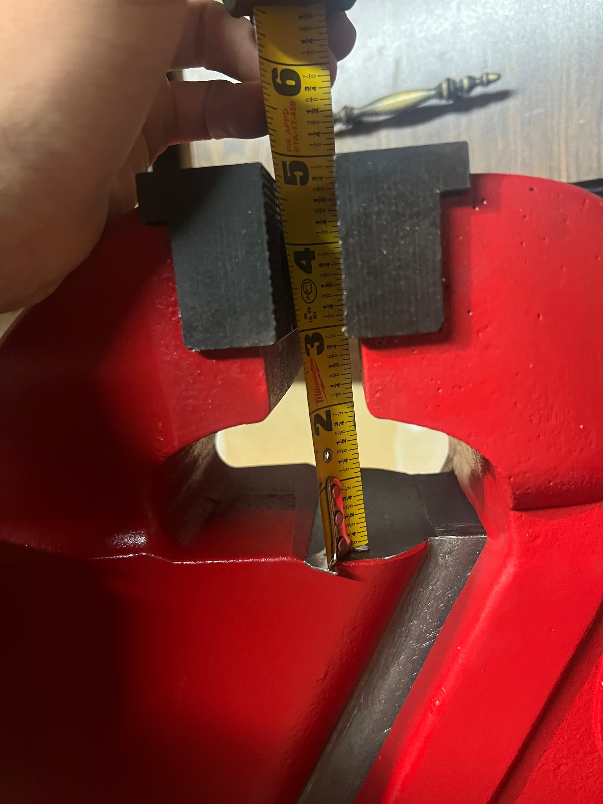

I think I’ll like it a smidge taller at 42.75" to the top of the jaws for two reasons:
  1. I’m 6’ tall and if I bend my elbow 90 degrees, that would put my elbow right at the top of the jaws.
  2. More importantly, all my tables are 38" high and I would like the bottom of the throat to match this height so I can use my other tables as supports for larger parts. I definitely wouldn’t want the throat lower than the tables because then the position of the tables would limit how large of items I can hold. Since the throat of the vise is 4.75" deep, that would put the top of the jaws at 42.75"
The vise is a total of 13.75" from base to top of jaws, so I will build a base with a height of 29".
In case anyone is wondering, here are some pictures with measurements.
The vises are available to pre-order (but it is actually more like a deposit until the vise is ready to be shipped out). I pre-ordered Feb 2, 2022 and the vise arrived June 5, 2023, so 16 months was my lead time. Maybe @Fireball_Jason will chime in with what the current total lead time is.
With regards to the size of the base, I am planning to make it 29" tall (see my rationale above). I have not yet decided how wide the base will be where it connects to the floor, but it’ll probably be a tripod design around 32" wide and 24" deep. If the front of the stand is 24" away from the wall, then the vise has enough room to spin 360 degrees (this is an excellent design feature). 32" wide because the vise is 16" from the center of the pivot pin to the handle with the jaws closed, so that is the minimum, and 32" wide will also provide good side-load support.
The vise rotates very well on the base. I believe mine may have a slight defect in the casting of the base that needs shaved off because it catches in one spot if I don’t have the screws loose enough. I’ll take it apart and look soon. Conversely, when you lock down the swivels, it stays exactly where you put it. The large tapered nuts in the swivel base provide plenty of traction to keep it from pivoting when you don’t want it to. I feel like it is worth noting that the swivel base is optional; you could mount the vise directly to the table if you didn’t need the swiveling functionality (which most people probably don’t - Maybe Fireball could sell a version without the swivel base).
