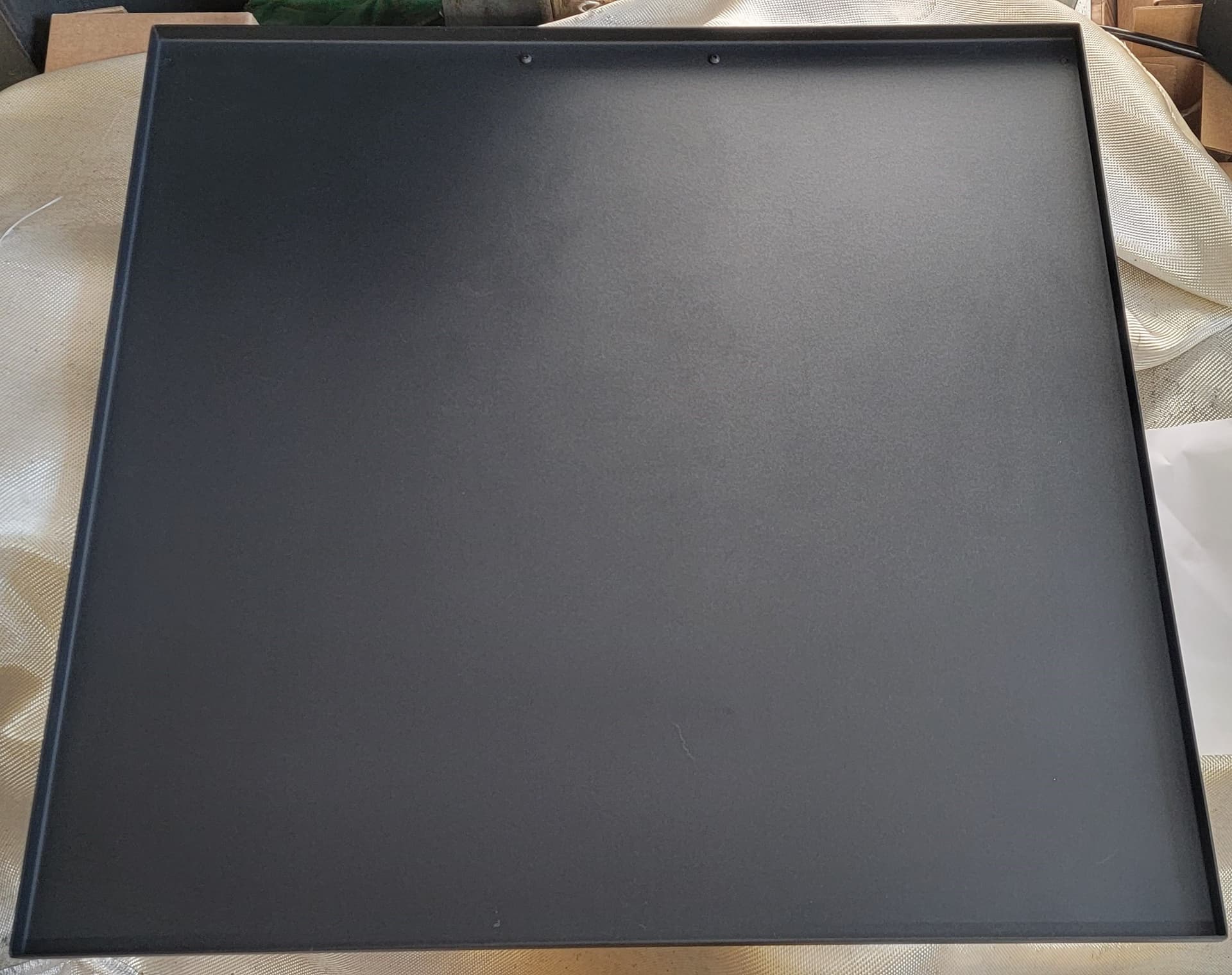

Also my main tray doesn’t have stoppers to keep it from falling out or the hole / plug to empty without pulling it all the way out:
Is that just a difference between the larger and smaller wagon kits, a difference of versions being released at different times, or is there an error?
Thanks!
Hey @wheelz,
Those features are only on the 54x30 dragon wagon, not the 36x24 dragon wagon.
