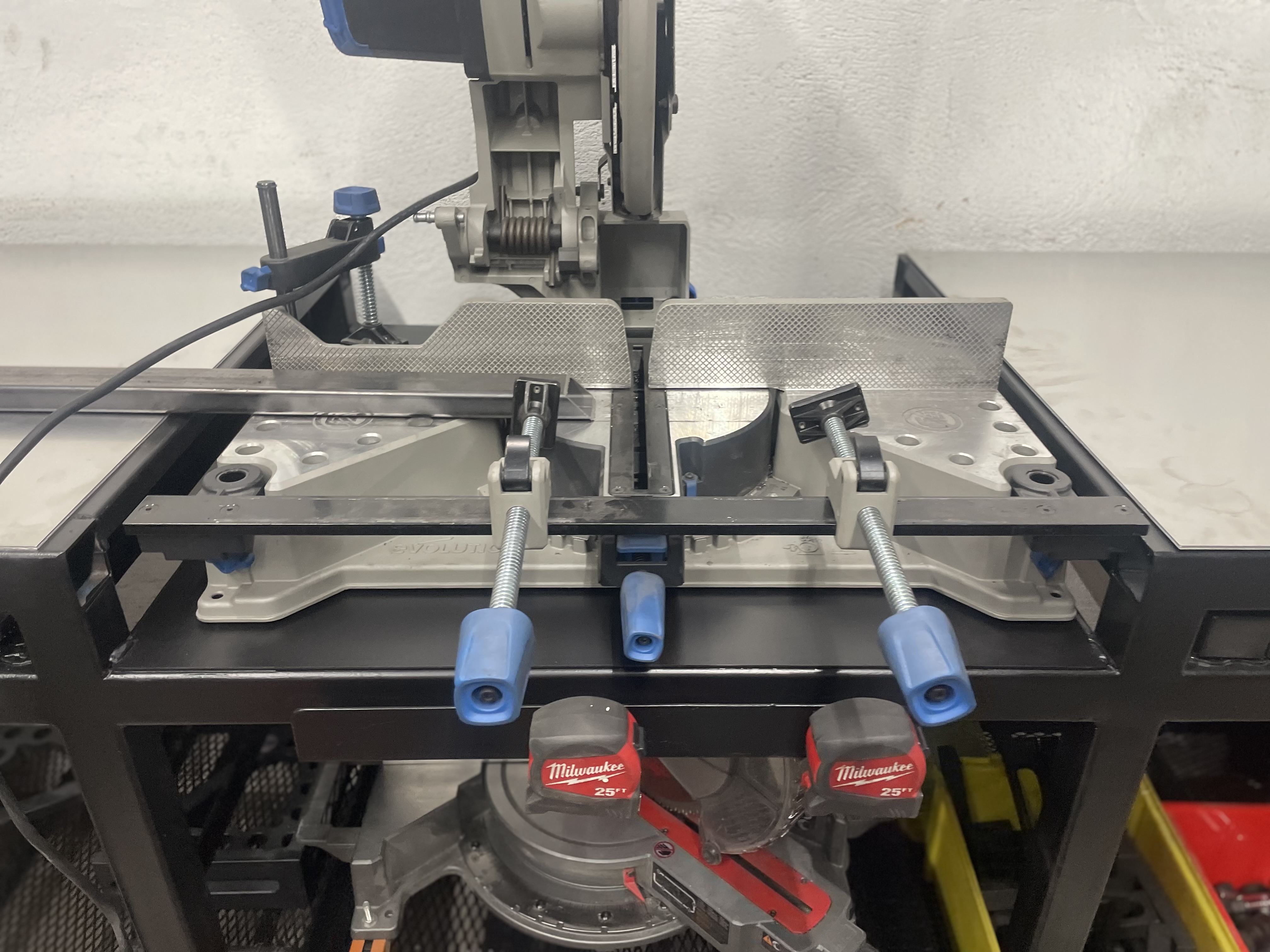

I made a bench for the 355 evolution saw. I plan on adding a fence with a sliding stop so I can made repeated cuts with out measuring
That is neat!
Almost to nice to use! Nice job
