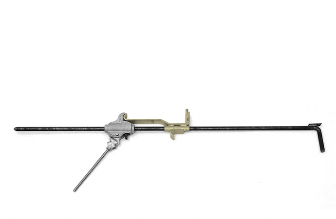

Well Fella’s turns out there is already something on the market that works seamlessly with this system it is called a monkey on stick and i use it often with this table. I have a hydraulic version though I have made though it is unnecessary for the most part.
Keysco monkey on a stick part number 77043
As a little tip into the hydraulic version look up a 5ton hydraulic gear puller from harbor frieght it doesnt take much creativity to figure out how to make what you all are going for from seigmund though truthfully I prefer the friction jack as you can literally feel what you are doing more than through the hydraulics
Yes maybe keep it simple like a port a power attachment or something.
I think the advantage to what was originally posted is that it can fit into smaller areas. With a 55" long tool, I can think of a lot of cases, including my most recent one, where that wouldn’t work. Now maybe you can use a different rod but even the main body of the mechanism seems like it would get in the way a lot.
The 5 ton jack gear puller may not always be able to be positioned correctly but could be modified, like you said.
