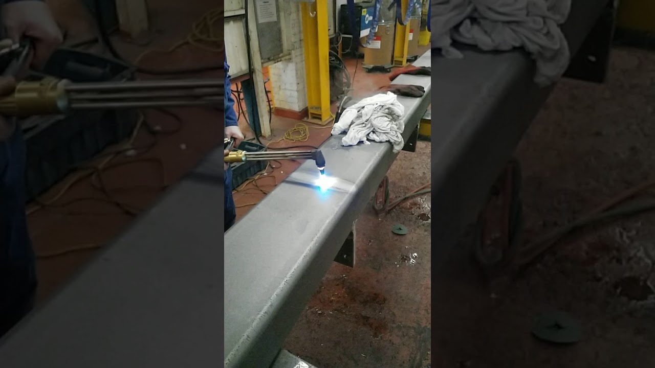

Here is a video that may help you understand how heat effects Metal when welding

you can see there is a plate welded to the bottom side of that tube. when welded it would have humped up on the side he is heating. That is because it shrunk on the other side. By heating it on the top side he causes it to shrink and pull back and in turn straighten the tube. This is not something you can just pick up a torch and learn overnight. To do this and be good at it takes lots and lots of trial and error.
This will help you understand why you you got to 1/32" and than went back when you heated the other side.
