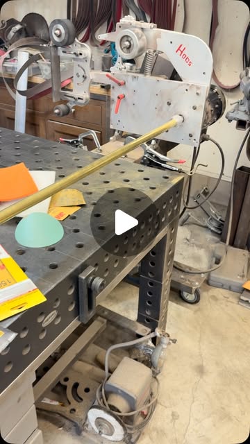

Here’s a short video of a set up I made to polish brass tubing. I used my Reeder belt grinder that has variable speed control (just make sure you start at the slowest setting :woozy_face::man_facepalming:t3:) and pulled the drive wheel off and made a coupling to hold the tube. Other end has a bearing the Perfect size but won’t be hard to make a spacing collar if needed. Works exactly as I needed it to.

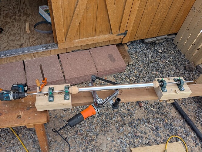

I tried grinding between fixed centers, quick improvised setup. About 1 minute per foot with a pretty even finished product. Worked pretty well but room for improvement in a few ways before its ready for show time.
So I’m building a pioneer style wood lathe, minus the drive system, but with pillow block bearings at both ends. Then I’ll turn a couple plastic cone centers and be in business. Adjusts to any size up to over 48”. Add a motor, drive pulley, and tool rest and I’d have a dedicated wood lathe.
Here’s the first “production ready” version.
Long enough wood with adjustable “tailstock” to turn 4 ft + tubes. 1/2” pillow block bearings with oak cone centers from a salvaged table leg. Let the tube sander auto-rotate the work or better, put a drill on there to set the pace. It’ll probably get a few improvements as I go along, but this works really well and is a great place to start.
What do you guys recommend for sandpaper - zirconia or ceramic? And are those “surface conditioning” belts that look like Scotchbrite any good on aluminum?
I’ll put the corded drill on there once I really get into it. The spring clamp holds the trigger down. 3/4” gr 8 bolts are total overkill but were in stock and the right length.
do you have the drill drill run fast, slow, medium speed?
The cordless drill for first test I ran on slow. A corded drill with the trigger clamped down will go full tilt which is probably ok. The tube sander is variable speed if I needed to slow it down for some reason.
Post pictures of the finished product, I would love to see it.
Sorry for the late update! Last fall I got a Shopsmith 10 ER for $30, then bought extension tubes for it to reach out to 4 feet (internal splices made on the metal lathe)
. Got a Vevor tube sander and turned wood centers on the metal lathe. Cheap live center in the tailstock. 120 grit ceramic sandpaper. Works great. I’ve run over 3,000 feet of 2" tubing through this setup and it really works well. If the tube has a little runout it’ll slow me down as the sanding pressure is reduced on the concave side. 2 minutes per tube unless there’s runout or deeper scratches to clean up, then maybe 4 minutes a tube. Short of a fancy centerless grinding/polishing machine this is pretty good. And, stand on the backside so the lathe rotation is opposite the sander.
