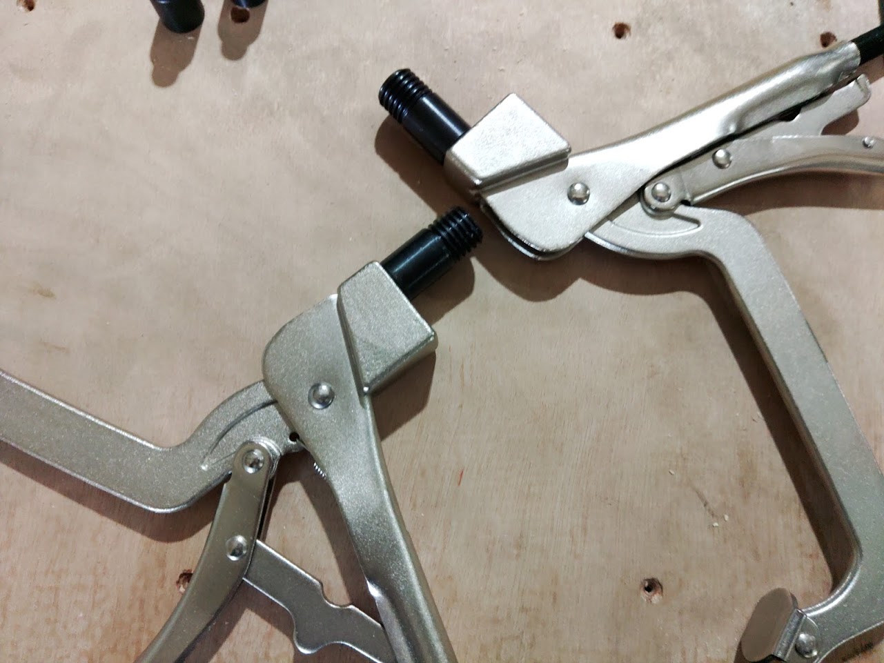

Started tweaking my fixture block pins to use in the clamps. Just for the occasion you want it to stay where you left it time and again… yes I have 3/4 wing nuts on order now
That’s looks handy
That should work pretty good. Are you planning to bolt them down when you use them?

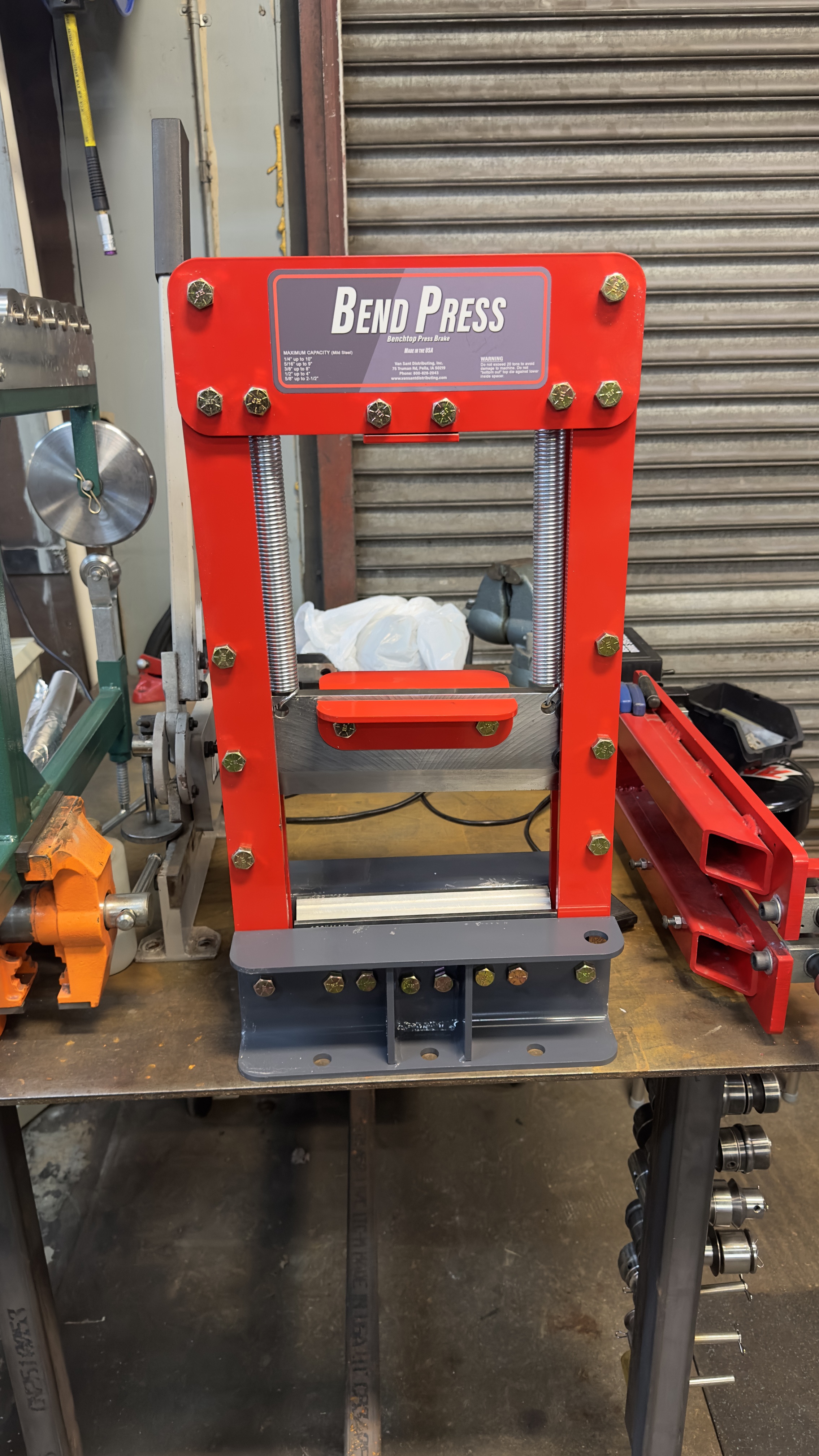

Can I ask why you chose that brake setup over some of the other options in the sub $1000 range?
Yeah I’ll bolt it down. This press brake has 5/8 holes so I’ll have to open em. I didn’t really shop around for press brakes. I saw this and liked the construction of it and the fact I’d just have to pull it out of the box and get to work. It was $800 with the v block. I could have just got the HF 20T bottle jack but i sourced a gray one from Sonic Tools for it to match the base of the brake. I’m still waiting for that to come in tho.
